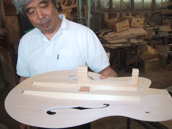

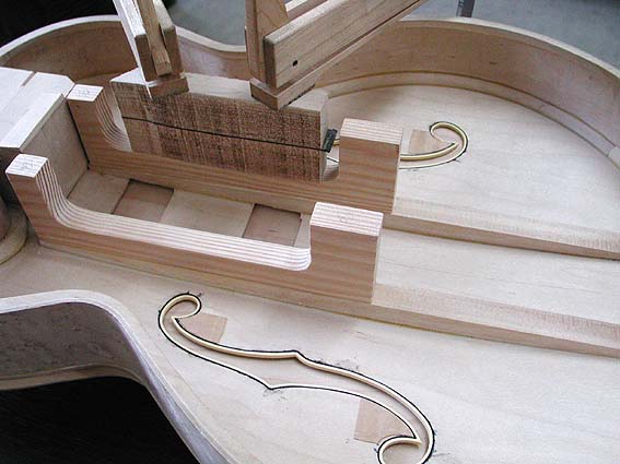

I am planning a hollow body elctric, modelled after Brian Setzer's '59 Gretch 6120. I wonder if anyone has info on these guitars; specifily the "trestle" bracing. Pictures or a drawing would be good! And does anyone know of sources for laminated plates for these?

A while back, I was looking into the same thing, and I found a couple of pics of trestle bracing...can't remember where I found them, but here you go :
You can check with Ken McKay about the pressed plates.
Hope this helps!

Thanks guys!
Russ, that picture is a big help. I've only been able to peek through the f-holes at them in the guitar shops, this makes it a bit clearer.
